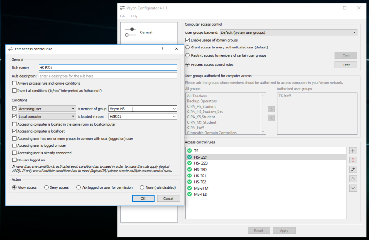

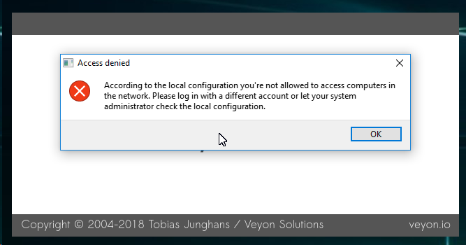

        I'd set up several access control rules to do what I thought should have worked, but-- instead when a teacher who is in the right group tries to sign in to Veyon Master, he is denied with the message, "according to local configuration you're not allowed to access computers in the network":
        An access control rule looks like this:
        (The first rule, "TS", checks if the Accessing User is a member of the Tech Services (IT) group; we can access any machine in our school district, and this does work. But, I need High School teachers to be able to control any lab machine in the HS but only lab machines in the HS, and same with our Middle School teachers...)
        The user signing in to Veyon Master is a member of the AD group, "Veyon-HS". It doesn't matter whether he signs in on his teacher machine, which is in the HSE221 OU, or my administrative machine which is not in "HSE221"; he receives the access denied message either way.
        Suggestions?

            @tobydox, the authentication message appears when the teacher is attempting to sign in to Master. The message appears regardless of the "Accessing computer is localhost" setting. (The teacher isn't getting far enough into Master to determine if he can actually contact Client computers!)
