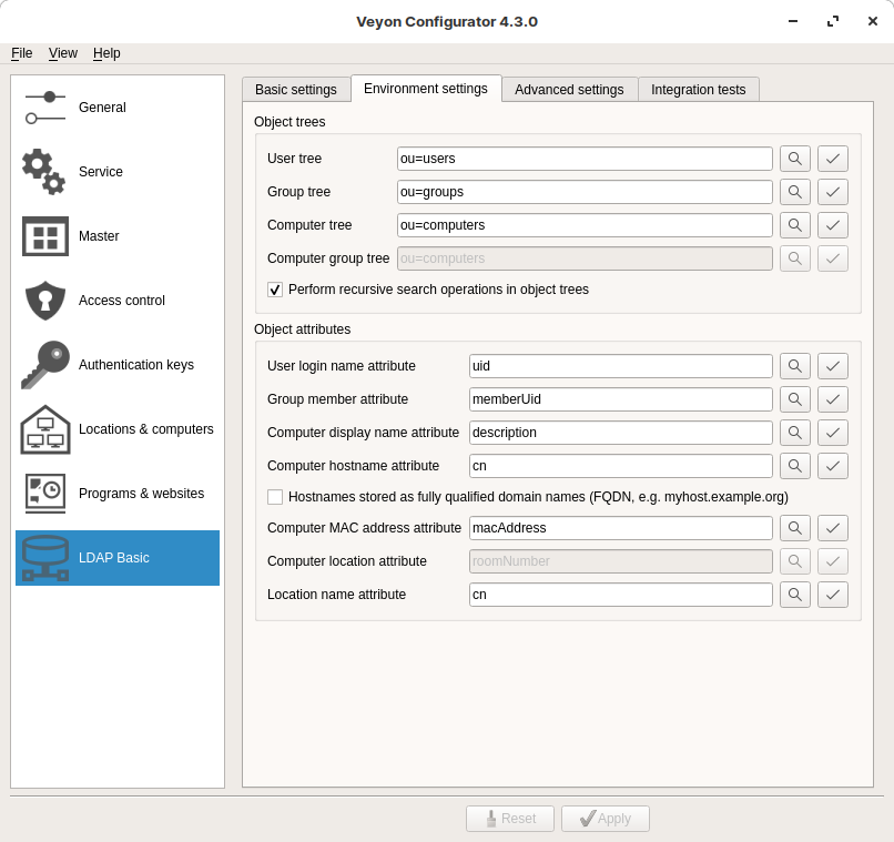

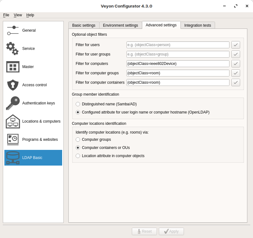

        This is what I have setup for OpenLDAP, if it helps.
        In OpenLDAP it uses multiple memberUid's for members of groups.
        These setting seem to work with my limited testing and knowledge.
        I changed the group member identification and filtered objects on the different OU's and then used the test to ensure I got back the right objects.
