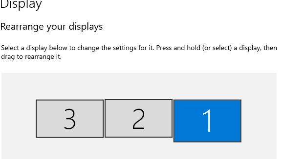

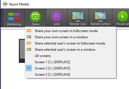

    OK!! I finally have a new clue!
    EDIT: Sometimes! I wrote the following...but then signed into two more clients, and now NOTHING is working again, not even on the one I had tested and resolve the following. ARGH!!!!
    What I THOUGHT was progress...
    If I select "All screens", Demo works, but only shows Display2). The problem is I don't really want Display 2 to go to the Clients. Display 3 is what is going to the TV monitors in the room (via HDMI splitter) and I would really like for what they see on the screen to be the same as what I display to the entire class.
    Also, Clients only receive some of my Display to their monitor...resolution differences...but this anomaly has been with Veyon for 3 years...so this is to be expected.
    If I select Screen 1 [\.\Display2], it works. No difference as above as to the amount that goes to the clients.
    If I select Screen 2 [\.\Display3], Demo does NOT work. Just sits there hanging o n "Connecting". Black screen on client until I stop Demo.
    If I select Screen 3 [\.\Display4], Demo does not work...same as above.
    I don't even know what Display 4 is as i have three Display using Built-in Video on VGA, Display Port and HDMI out all working together for 3 monitors.
    But, this work before on 4.3, just stopped working on 4.4.2. A version after 4.4.2, maybe 4.5?, brought in the option to select a screen/display. That version didn't work for crashing, nor Demo. Maybe right before you all added the option to select the screen, the coding was added that broke the Demo. ??? (just spit balling there).
    So, 4.5.2 is stable. And I have now determined that some of the options in Demo work.

      Thanks for figuring out! So it seems to be related to a non-standard arrangement of screens. I'll test this and if necessary provide a bugfix ๐Ÿ™‚
      D 1 Reply Last reply
