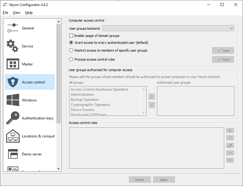

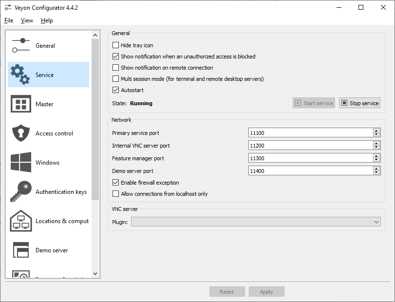

                Check Configurator settings at the computers, do they match the images below?
