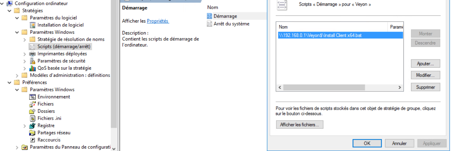

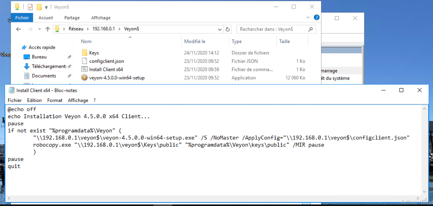

So I want to make a deployment, and since there is no . MSI We are obliged to go by script in the GPO as follows:

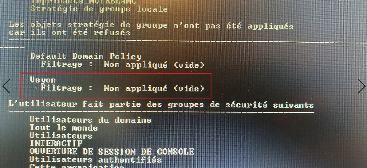

However, when starting Pc’s (example from a Professor and Student account nothing happens, the GPO’s is not taken into account

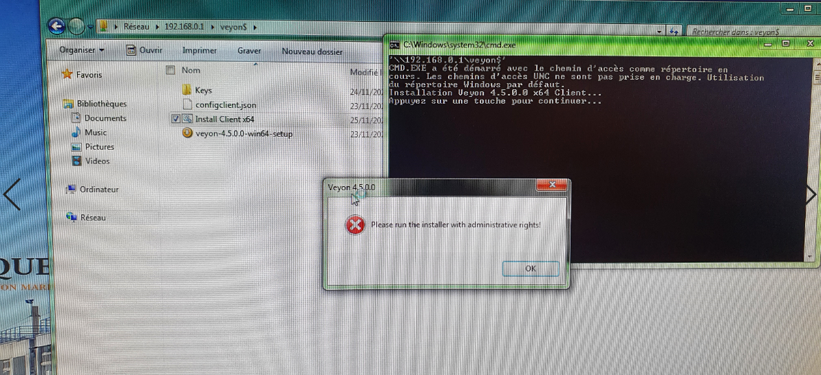

By manually launching (always since a Teachers or Students session) we realize that we need the administrator rights for the installation to be done... however it seemed to me that by GPO it was the local administrator account that did the installation.
Can you tell me how to force the installation.. I tried many scripts... to put the "Veyon" folder in local, to make a script with the administrator account and password indicated... nothing works, I have no idea anymore to pass this installation without logging in on the 70 posts !

I see you are running the script as a Computer Configuration startup script.
Possibly the Veyon policy is not linked to the desired computer OU or the correct computer OU.
Perhaps the student computers do not have access to the Veyon$ share. Check the GPO to be sure the Authenticated Users group has Read and Apply access.

Perhaps the student computers do not have access to the Veyon$ share. Check the GPO to be sure the Authenticated Users group has Read and Apply access.Hello,
In my screenshots we can see the Veyon rule, but it is not applied.
Users do have read / write access to the Veyon$ folder!Also, I haven't had time to try your solution yet
