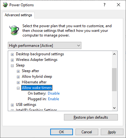

          As RNETuband said a scheduled task could be used to trigger a restart of the computer after hours with the task condition checked to ‘Wake the computer to run this task’. Configure your Veyon installer GPO to run as a startup script to avoid veyon-master.exe being in memory at the time the installer runs.
          Check the advanced settings of the current power plan to make sure the Sleep category has the ‘Allow wake timers – Plugged in” option set to Enable.

            @itguy I've tried the out-of-hours reboot before, without success. This may be the step I was missing.. How can I set that with a GPO? That option doesn't appear in the Power Plan preferences on our system

              From a command prompt enter:
              powercfg -attributes SUB_SLEEP BD3B718A-0680-4D9D-8AB2-E1D2B4AC806D -ATTRIB_HIDE
