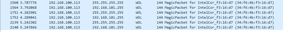

    I think I've found a little bug with the WOL implementation/I would like to suggest a little improvement :).
    I'm currently testing veyom for a classroom where PCs have two network interfaces. The classroom data are imported from our Microsoft AD. I have configured a script to add all MAC-addresses from our DHCP server to a AD-attribute (extensionData). The AD shows me the data as follows.
    If I now try to wake those PCs, only the first MAC address in this attribute gets a magic packet send. All other MAC addresses get ignored:
    In addition it seems that the AD stores the different MAC addresses in descending order. Therefore the WOL works only, if the LAN interface has the higher MAC address.
    Would it be possible to extend Veyon to send magic packets to all MAC addresses stored in AD? If so can I help somewhere?
