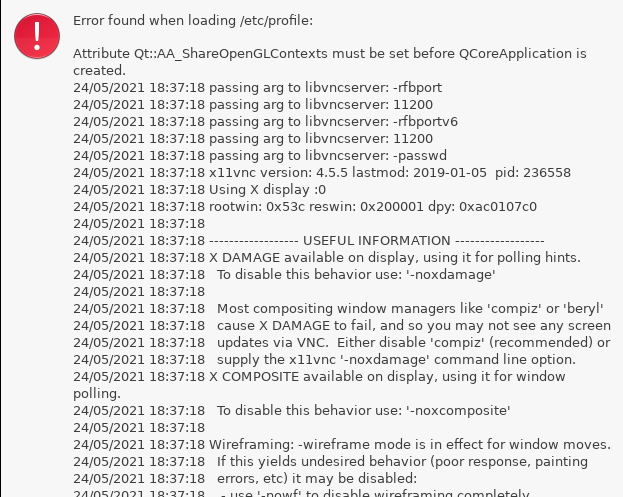

                I waited several minutes but nothing good happened.
                Here is the result of
                $ ps auxww | grep -i veyon
                root        1058  0.1  0.9 328756 30408 ?        SLsl 19:57   0:01 /usr/bin/veyon-service
                gdm         2165  0.0  1.7 291328 56388 ?        Sl   19:58   0:00 /usr/bin/veyon-worker {8e997d84-ebb9-430f-8f72-d45d9821963d}
                olivierk    2207  0.0  1.7 439036 57024 ?        Sl   19:59   0:00 /usr/bin/veyon-worker {8e997d84-ebb9-430f-8f72-d45d9821963d}
                olivierk    2912  0.0  0.0  11468   732 pts/1    D+   20:11   0:00 grep -i veyon
                You can see veyon-service launched by root and two veyon-worker(s) run by gdm anf by me. They both have the same GUID. Don't know if it's okay. Anyway, there is no veyon-service running.
                  The problem in all these cases is that the veyon-server process is not running. It's launched by the veyon-service program (systemd unit veyon) to run inside the individual user sessions. However for some reasons it seems to be not started properly or crashes. A running systemd service "veyon" only indicates that the service itself is running, not the server which provides actual computer access (and listens at port 11100 etc.).
                  According to @olivierk 's journalctl output for veyon, the service first starts a server instance for the login screen. Once the user logs in, the login session goes away and the server is stopped and a new one is started for the user session. The message server still running - killing now indicates that the previous server instance did not terminate properly in time so the newly started server is not able to listen at port 11100, even if the previous server eventually dies a few seconds later. What you could try is to increase the Minimum session lifetime before server start setting (Veyon Configurator -> View -> Advanced, go to page "Linux" (requires Veyon 4.5.5 or newer)). The service should then wait a longer time until trying to start the server for the user session.

                    I started "veyon-server" as a USER directly and got these messages:
                    08/05/2021 17:42:33 Listening for VNC connections on TCP port 11200
                    08/05/2021 17:42:33 Listening for VNC connections on TCP6 port 11200
                    08/05/2021 17:42:33
                    08/05/2021 17:42:33 Xinerama is present and active (e.g. multi-head).
                    08/05/2021 17:42:33 Xinerama: number of sub-screens: 1
                    08/05/2021 17:42:33 Xinerama: no blackouts needed (only one sub-screen)
                    08/05/2021 17:42:33
                    08/05/2021 17:42:33 fb read rate: 305 MB/sec
                    08/05/2021 17:42:33 fast read: reset -wait  ms to: 10
                    08/05/2021 17:42:33 fast read: reset -defer ms to: 10
                    08/05/2021 17:42:33 The X server says there are 10 mouse buttons.
                    08/05/2021 17:42:33 screen setup finished.
                    08/05/2021 17:42:33
                    The VNC desktop is:      localhost:5300
                    08/05/2021 17:42:33 possible aliases:  localhost:11200, localhost::11200
                    PORT=11200
                    Have you tried the x11vnc '-ncache' VNC client-side pixel caching feature yet?
                    The scheme stores pixel data offscreen on the VNC viewer side for faster
                    retrieval.  It should work with any VNC viewer.  Try it by running:
                        x11vnc -ncache 10 ...
                    One can also add -ncache_cr for smooth 'copyrect' window motion.
                    More info: http://www.karlrunge.com/x11vnc/faq.html#faq-client-caching
                    08/05/2021 17:42:33 Got connection from client 127.0.0.1
                    08/05/2021 17:42:33   0 other clients
                    08/05/2021 17:42:33 check_access: client 127.0.0.1 matches host 127.0.0.1
                    08/05/2021 17:42:33 incr accepted_client=1 for 127.0.0.1:40640  sock=24
                    08/05/2021 17:42:33 Client Protocol Version 3.8
                    08/05/2021 17:42:33 Protocol version sent 3.8, using 3.8
                    08/05/2021 17:42:33 rfbProcessClientSecurityType: executing handler for type 2
                    08/05/2021 17:42:33 copy_tiles: allocating first_line at size 33
                    08/05/2021 17:42:33 Pixel format for client 127.0.0.1:
                    08/05/2021 17:42:33   32 bpp, depth 24, little endian
                    08/05/2021 17:42:33   true colour: max r 255 g 255 b 255, shift r 16 g 8 b 0
                    08/05/2021 17:42:33 no translation needed
                    08/05/2021 17:42:33 rfbProcessClientNormalMessage: ignoring unsupported encoding type ultraZip
                    08/05/2021 17:42:33 Using compression level 9 for client 127.0.0.1
                    08/05/2021 17:42:33 Enabling KeyboardLedState protocol extension for client 127.0.0.1
                    08/05/2021 17:42:33 Enabling NewFBSize protocol extension for client 127.0.0.1
                    08/05/2021 17:42:33 Enabling SupportedMessages protocol extension for client 127.0.0.1
                    Another Client was able to connect now!
                    So: it runs when the "veyon-server" was started again ... do you have an idea, why it crashes?
                    First I tried it as root -- but the "veyon-server" didn't start!
                    X11 MIT Shared Memory Attach failed:
                      Is your DISPLAY=:0 on a remote machine?
                      Suggestion, use: x11vnc -display :0 ... for local display :0
                    caught X11 error:
                    08/05/2021 17:12:29 deleted 32 tile_row polling images.
                    X Error of failed request:  BadAccess (attempt to access private resource denied)
                      Major opcode of failed request:  130 (MIT-SHM)
                      Minor opcode of failed request:  1 (X_ShmAttach)
                      Serial number of failed request:  60
                      Current serial number in output stream:  94
                    W 1 Reply Last reply
                    • W white_rabbit
                      caught X11 error:

                      I don't know if this helps ... but when I start "veyon-server" as a login-Script I get this message:
