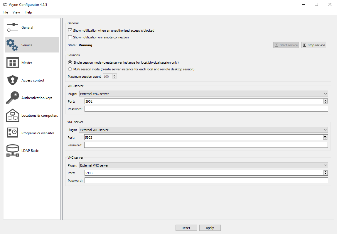

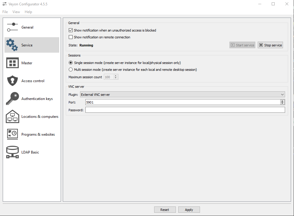

    I got myself to situation where would be really great to be able to handle more than one VNC server in configuration. Basically I need one VNC connection to PC1 NIC1 port 5901 and second VNC connection to PC1 NIC2 port 5902. See screen below so you can understand exactly what I mean.
    Something like this would be great.
    Instead of just one VNC server.
