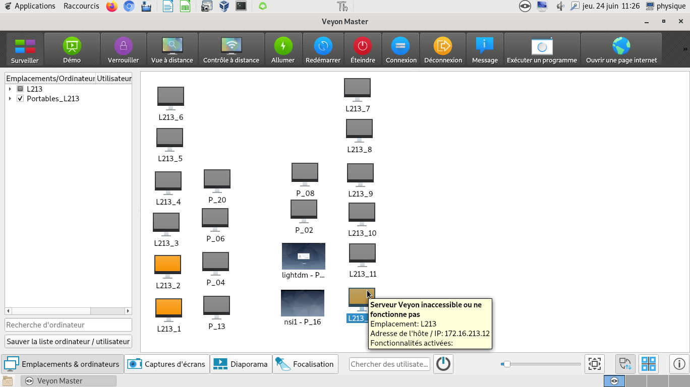

        I've changed the /etc/gdm3/daemon.conf : uncomment the "#WaylandEnable=false" line. I've also tried to start the session by manually choosing an Xorg session but the problem is the same :
        On this screenshot :
        • the left and right columns : the PCs with Debian Buster and GDM ; the master is the same model.
        • the two colums in the middle, the old laptop PCs with Debian Buster and lighDM
        Five PC where started :
        • the master can see the two laptops (one with a started session, the other one waiting for a session login)
        • the master can't see the 3 others.
        On the laptops the command "telnet localhost 11100" is OK but not with the 3 others. For those ones the ping with the master is however OK.
        An idea ?
        V.Le Mieux
