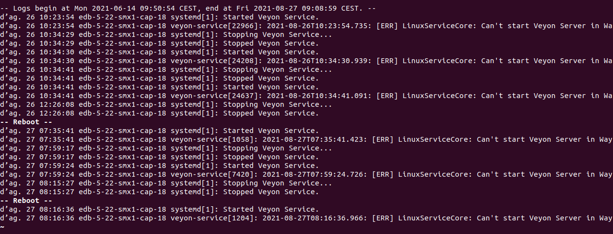

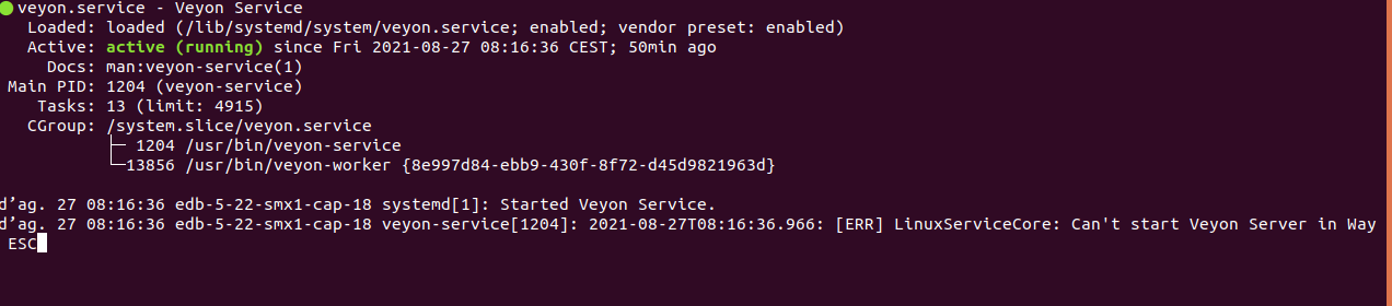

          Bielet
          @kamik
          It seems a problem with wayland. I am using Ubuntu 18.04.5 LTS
