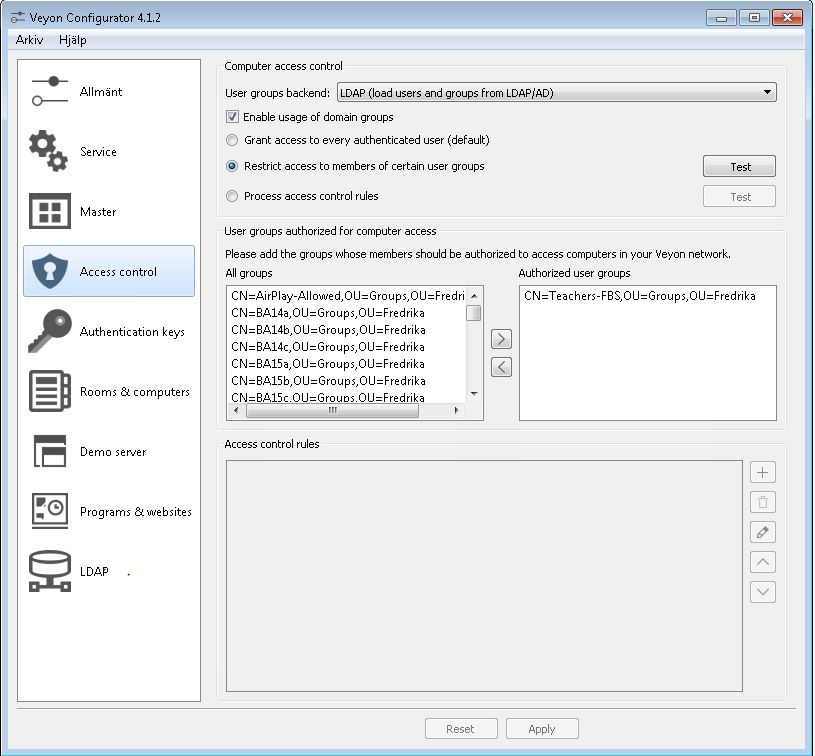

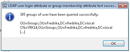

        It's hard to check group membership when the alertbox is well tiny.
        Posted the settings I use.
        When I run the Test on restricting access it gives me an allowed on all users not only teachers and if I delete the group so I have no authorized groups I get not allowed on all users. So it's doing someting, just not the think I need. =(

                Something seems to be wrong related to querying all groups of a user. According to your screenshot the user is member of 385 groups which is rather unlikely. I assume all AD groups get listed here (which is a bug in all versions including 4.1.3 which will return all groups instead of none in case of configuration problems- will be fixed in 4.1.4) which explains the behaviour regarding the non-working access control. This basically means some of your settings are not correct yet:
                • Environment settings / User login attribute
                • Environment settings / Group member attribute
                • Advanced settings / Group member identification
                If your AD stores group members with their DNs (groups have entries with member: CN=foo,OU=Users,DC=example,DC=org) make sure to use member for Group member attribute and set Group member identification to Distinguished name. The first integration test should then return a much smaller number of groups. Afterwards you have to deploy the updated configuration to all computers.

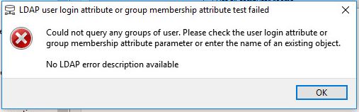

                  alt text
                  Is the error I get when putting member in the group enviroment setting.
                  Maybe I should wait for the 4.1.4 update ?
