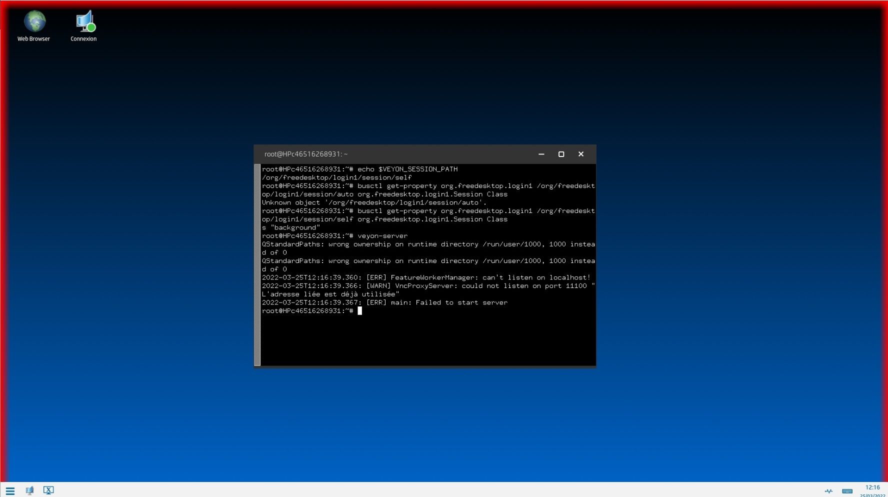

        achar74
        @tobydox
        Thanks a lot.
        One precision, the problem seems to be on the client, not on the master I think. Because, between master windows 11 and client windows 11, everthings work. But between the same master windows 11 and a Linux client, demo mode not working, nothing for the lockscreen too.
        The error at the command veyon-server is on the Linux client, but i don't know if it need to be started on the client...
        Here is the result on the Linux client :
        Best regards.
        • A achar74
          @tobydox
          Thanks a lot.
          Best regards.
