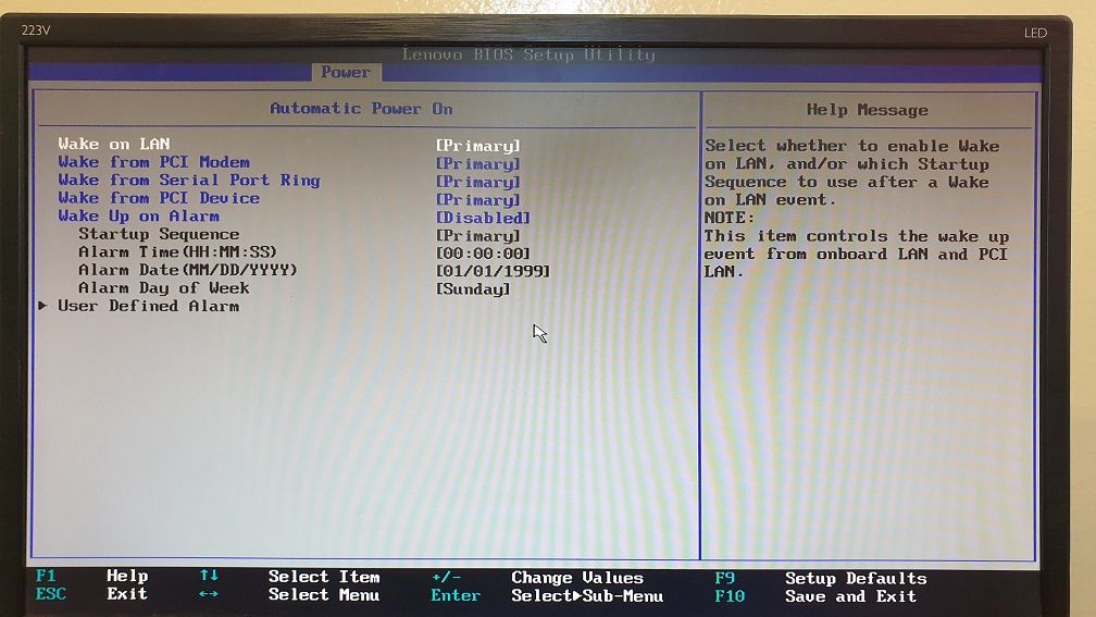

    1] I enabled Wake-On-LAN in BIOS:

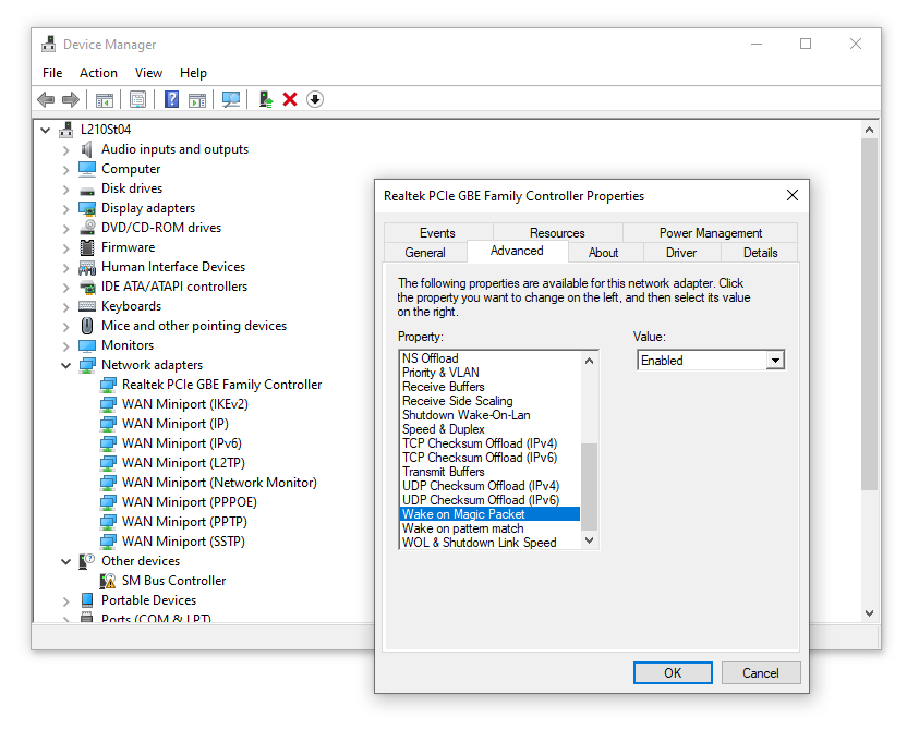

    2] Have verified "wake on magic packet" is enabled:

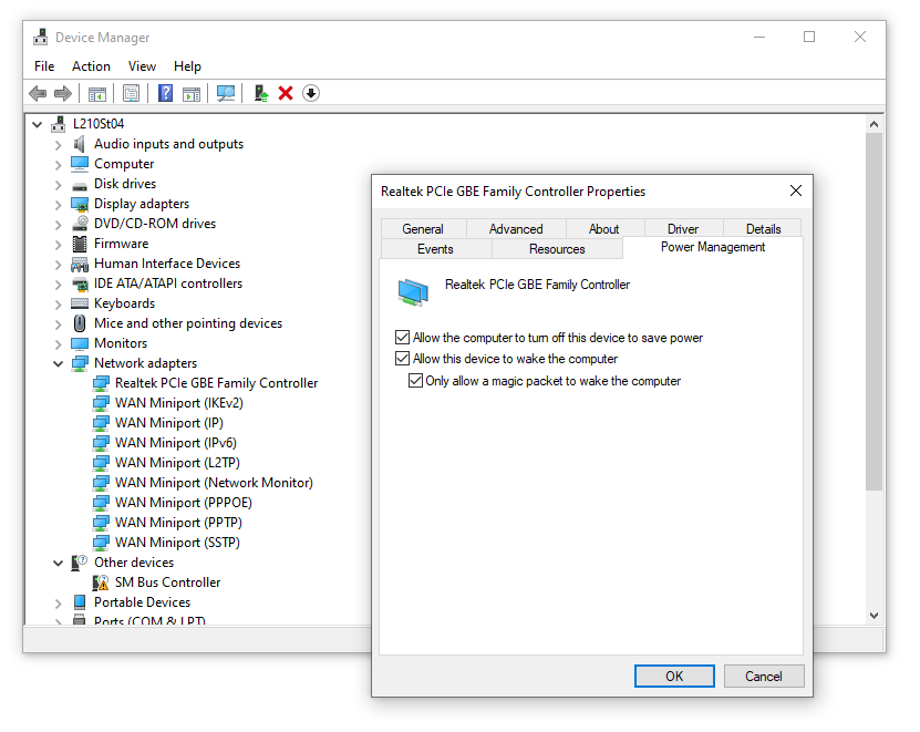

    3] Checked "only wake on magic packet":

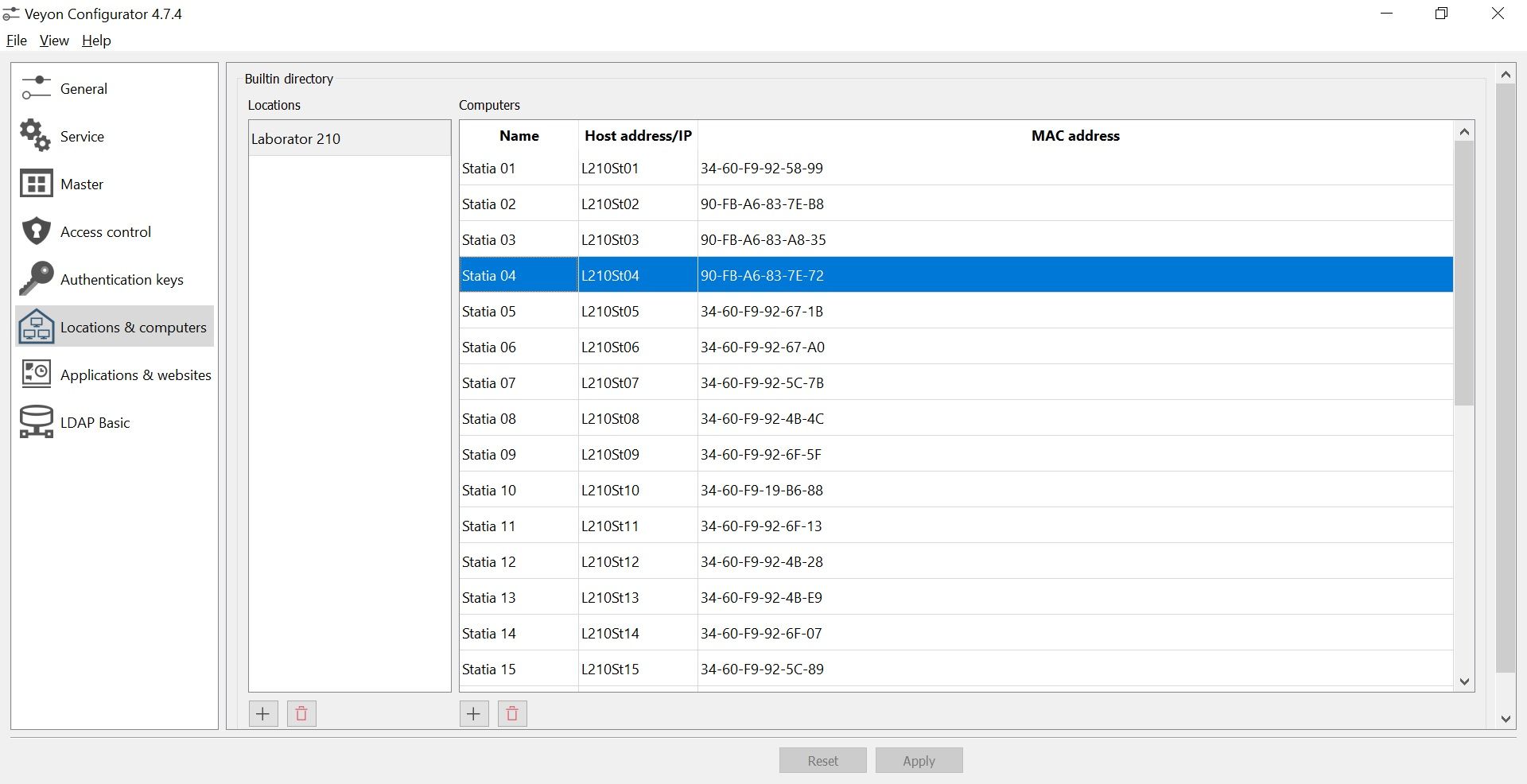

    4] Entered MAC in Veyon Configuration:
    5] All computers are connected to the same router, directly [professor] or through 2 swithches [the 30 stations].

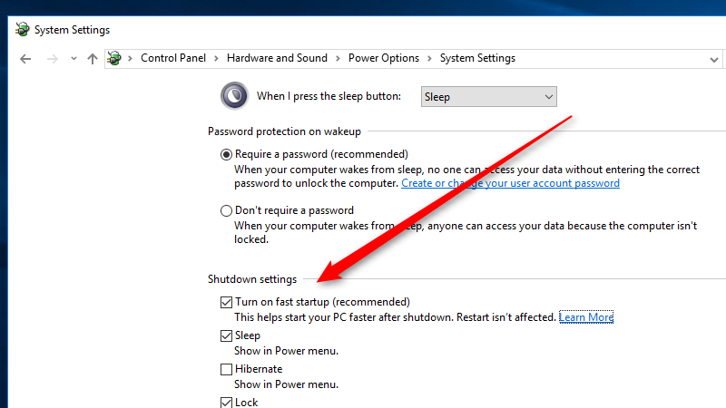

      First try disabling "fast startup" on the client computers:
      If that doesn't help, the issue may be your network configuration. Are the computers all on the same LAN or VLAN? Are the two switches just small unmanaged switches or are they routing the traffic in some way?

          Sorry for the late repply...
          Disabling "fast startup" did the trick for me.
