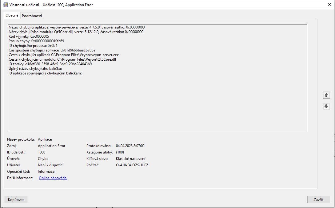

    Hi, I have problem vith Veyon in PC lab (16 PCs) - using v4.7.5.
    I can switch on all of them correctly. I can see cca 12 of them in Veyon Master and can work with them. The other ones (4 PCs) orange-red flash (it is possible to start the Veyon service manually in Veyon configurator or windows services, after that they work).
    Anyway after 5 minutes the connections to all the computers is down (all 16 PCs orange-red flash). The service on PCs is running, but nothning in Veyon Master works.
    I tried turning off Windows Firewall, antivirus, delay start of Veyon service, Static IP adress...
    When I manually restart the Veyon service on all PCs, everything is OK and works.
    After restarting computers... the problem appears again... 5 minutes and connection lost.!
    enclosing windows log from Event viewer.
    Thanks a lot for any idea!

      Solved - application MagicInfo and his uvnc modul made the problem. After killing everything run!
