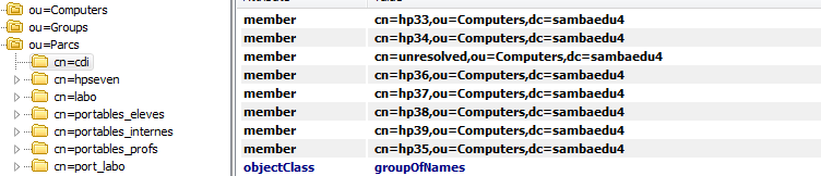

    I am trying to use Veyon with a samba edu server.
    It's a linux server based on samba and ldap.
    In Veyon config tool I have matched users ldap informations and Veyon tests are working.
    My problem is about computers and groups :
    ldap root "Parcs" contains computers groups like above :
    • I can :
    • list computuer groups
    • lists computers
      but can't get computer associated to Parc / computeur room
    I don't understand difference between computer group adn compter room.

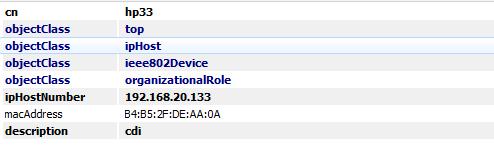

    Computer sample :
    I have tried to add group information in "descritpion" and configured Veyon but also not working.
    My questions :
    • Can Veyon work with this king of ldap structure ?
    • Veyon can't find a computer from Ip (on test at last config state), storing ip in ipHostNumber seems to be a normal use of it ?
    Thanks for this great tool and for your help.
    A lot of people are using Samba Edu in France, a comptible configuration will help a lot of people.
    Thanks a lot
    ludo

        • L Offline
          L Offline
          ludo2223
          wrote on last edited by ludo2223
          Not working because content of member (cf picture bellow) is not hp35 but cn=hp35,ou=....)
          Any idea ?
          Thanks a lot
