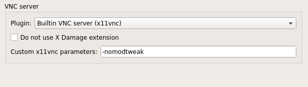

        ttucker
        This is caused by a problem with VNC. It can be fixed by doing the following:
        Load veyon configurator
        Click on Service on the left side
        Change the VNC server settings as follows:
        Plugin: Builtin VNC server
        Custom x11vnc parameters: -nomodtweak
        This must be done on both master and remote.

          Thanks ttucker... solved 🙂
            Thanks for providing the investigations and sharing the workaround! While scrutinizing the issue I spotted a problem in the build system leading to relevant x11vnc features such as the keyboard extension not being enabled at compile time. This will be fixed in 4.1.6.
