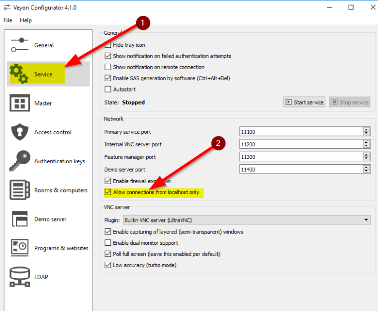

    Hello is there a way that I can block or disable other Master users from viewing my screen or controlling it?

      Hi @rharris, I believe there should be a few ways to do this.
      1. Don't automatically start the Veyon service on the Teacher/Master machine.
      But the main one would be:
      1. Access Control rules should be able to be set up to avoid this.
      (There would be a few different ways to use Access control rules to prevent this).

        Ok I will look into the Access control method thanks for the quick reply.
          brad.mcclintock
          Or make sure you have 'Allow connections from localhost only' selected in the configuration for the Master/Teacher machine.

            @brad-mcclintock thanks for the screenshots I will use that method going forward for the other admins here.
              Disabling the service at all is not a solution as the demo mode will not work in this case. The suggested option to allow connections from localhost is the easiest way if you do not want to set up access control rules.
