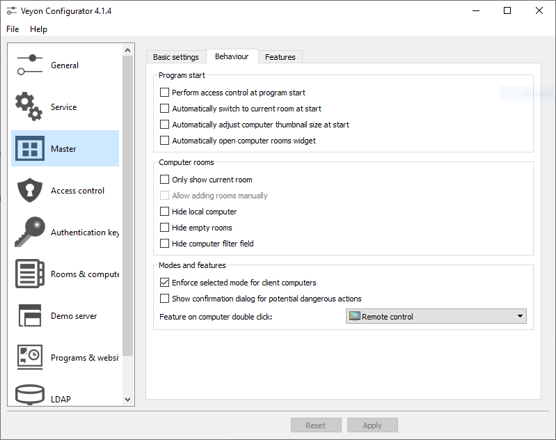

      @FabVas Try enable 'Enforce selected mode for client computers' in your Master configuration under 'Behaviour'.
        FabVas
        @Sanny thanks for this help. I am not able to manage this setting but I will inform the IT service about this. I let you informed as soon as I have any news.

          Ask your IT if he have installed the interception driver? Without them Veyon can't lock keyboard and mouse.
          Demandez à votre informaticien si il a installé le pilote interception? Sans ça Veyon ne peut pas bloquer le clavier et la souris.
