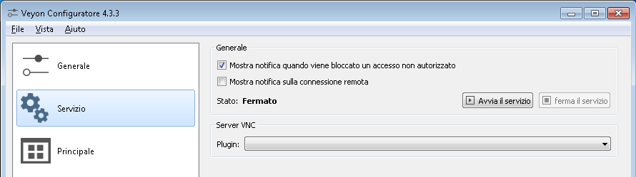

                      #14
                      I'm sorry, no good news:
