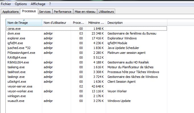

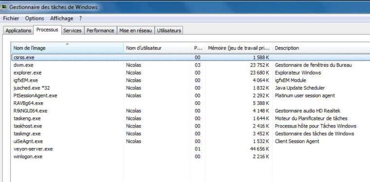

a note however:

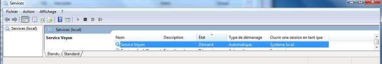

Veyron service is started on both accounts (admin and not admin)
the Veyron-server.exe process is started on both accounts
the vey-ron-worker.exe process is only started on the admin account
process account admin :
process account not-admin :
services admin and not-admin
