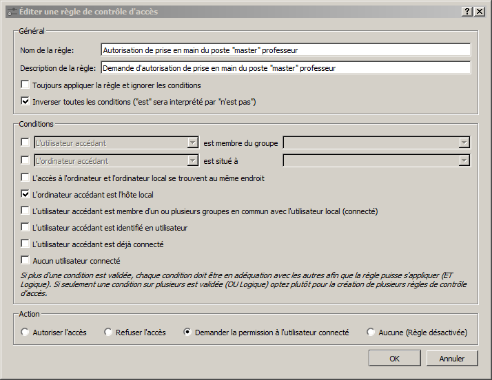

  • 0 Votes
    2 Posts
    616 Views
    E
    Hi, I solved my problem although I do not understand why it didn't work. I changed the condition : General : inversion of all conditions : checked Condition : checked accessing computer is in C12 rem: C12 is the place of clients accessing computer is local host : checked unchecked Action : Ask permission to the connected user : checked [image: 1566971725894-2019-08-21-07_29_41-console-de-gestion-veyon-4.2.4.png] Thank you.
